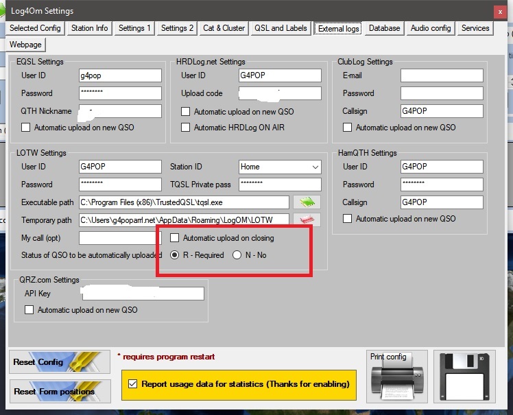

There is a new user selection in the options to choose what the result of select required does, r requested or n no

This is the Options tag, I will amend the user guide when I have time

Found it, working fine - many thanks

I've looked over the manual. I'm probably having a Stupid Moment :oops: , but I can't figure out R-Required and N-No. I end up with L4OM wanting to upload my entire log, even though I might have only one or two QSOs to send. All I want to do is have it automatically upload my QSOs from the current session, whether it be one or 100. How do I do that?

How are the QSO's marked for LOTW upload in your logbook they will either be R- Requested or N-No
Select whichever way they are marked in the options/External logs window and check the 'Automatic upload' check box
Now any QSO's that have not been uloaded will be uploaded when you close Log4OM - You will be prompted to click the upload button
