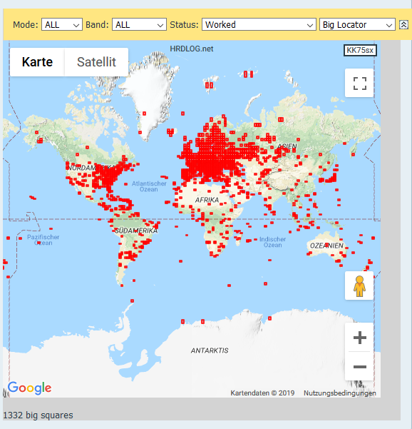

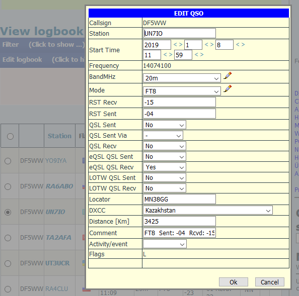

Hello John,
i have opened my logbook at Hrdlog.net and i have checked some uploaded
contacts with the "Edit" function. All locators are o.K. in my hrdlog.net book.
Also my locator map is looking fine:

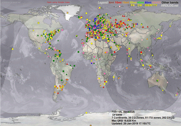

Please check out my QRZ.com page where I included the map.
https://www.qrz.com/db/DK9JC
All the markers were just in the center of the worked country. I then deleted all my automatic uploaded entries, re-uploaded my ADIF out of Log4OM where it worked then. This leads me to the conclusion that something is wrong in the automatic upload (Log4OM to HRDLog API --> "Loc" missing).
Have you uploaded them via ADIF Import? That also works on my side but not automatically via Log4OM (API to HRDLog).DF5WW wrote: 21 Jan 2019, 14:46 i have opened my logbook at Hrdlog.net and i have checked some uploaded
This is not the map I am referring to. But I checked my online map with the one you showed and they look pretty much the same. So the database is the same.

B.t.w. the HRDlog map on your qrz.com account is simply the DXCC map of HRDlog.net. This means that
are only your worked/confirmed DXCC entities will be shown with a colored dot in the middle of the
worked country. It´s not a Locator map ....
My DXCC map has the same structure. Only a few coutries more, HI ...

I don't think so to be honest. Just check your USA for example. Much more spots than just a single DXCC.DF5WW wrote: 26 Jan 2019, 17:16 B.t.w. the HRDlog map on your qrz.com account is simply the DXCC map of HRDlog.net. This means that
