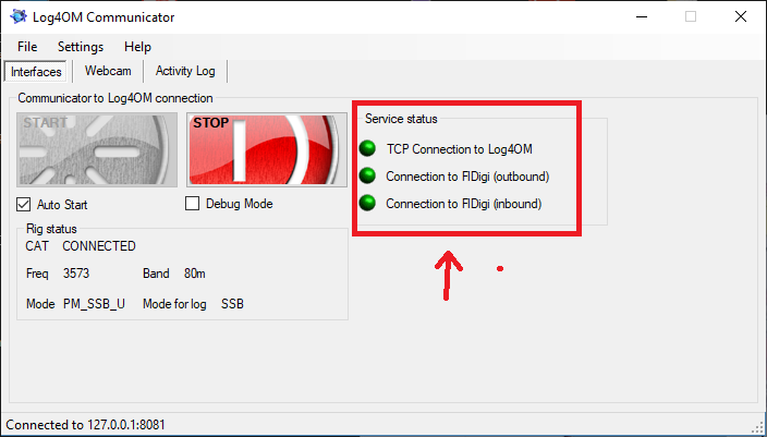

Last but not least, are all the lights are green in the Log4OM communicator when
Fldigi and Log4OM are running ?
If not all green you can check them manually .....

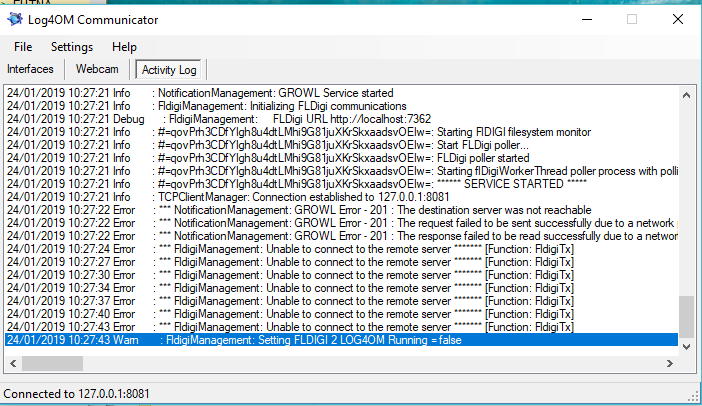

The connection buttons to and from FLDIGI are both red
If I manual push the start buttons - they both go green for a few seconds but then return to red. If I switch to the log tab, I see it trying to connect but keep getting the "unable to connect to remote server" message (as in the log screen capture above"

For some reason the FLDigi server is not available, according to the logfile you posted here.

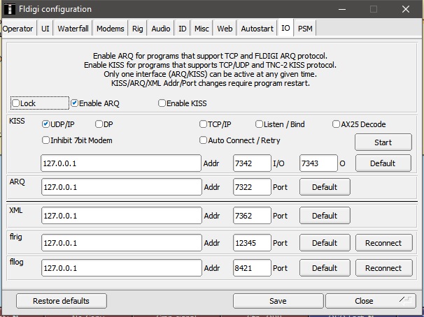

also are you sure that you have changed nothing here?
The lock box should be checked I unchecked it for clarity of image

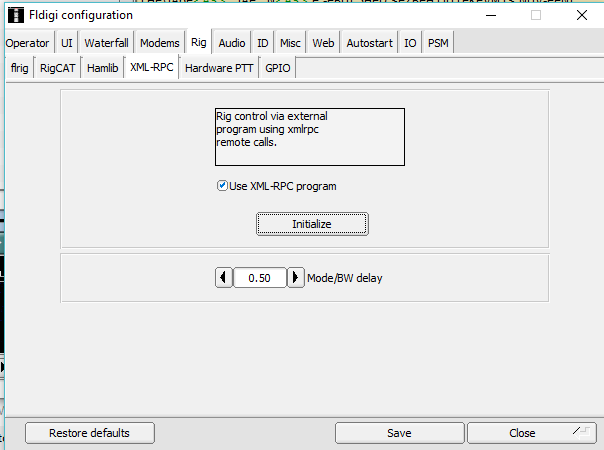

Fldigi configuration looks fine
All of the other tabs in rig control are not selected (FLrig,RigCat,Hamlib and Hardware PTT)

No it's NOT the same
You have changed the XML port number, change it back to match the screen shot I posted 7362
Don't forget to save the configuration from the Fldigi file menu as well as the window above

No idea how that got changed as I have never been into that screen before, and I would have assumed locked means it cant be change.
Nevertheless, that immediately fixed the problem
