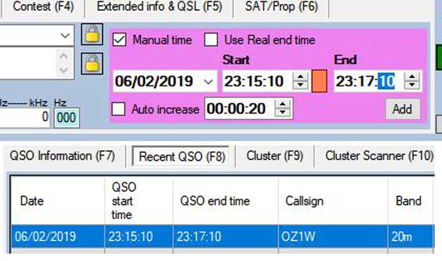

Re: QSO end time
Lenny
The simple way is for you to enter the manual start time by subtracting a couple of minutes from the end time, that you recorded on paper, in your head and then afterwards enter the end time, both will be faithfully reproduced in the log as shown below from the test I just did.
In this example the end time recorded on paper was supposedly 23:17;10 so I first entered 23:15:10 as a start time followed by entering the 23:17:10 in the end time field.
Saves us re-writing the code also!
