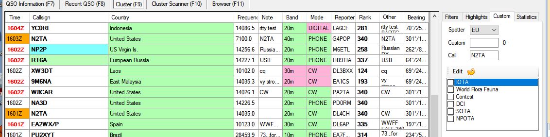

radioman-ct wrote: 16 Mar 2019, 15:36 Hello, I am looking for instructions as to how to create a custom filter for the cluster that will only show a specific call sign in the cluster results.
In Log4OM you can only create scripts for 'Highlights' and there is a ready made function for that which is 'Call' in the custom tab which adds a highlight to the time, see below
However if you want to ONLY SEE spots relevant to a special call then you can send a filter to the cluster server that you use, here is a link to the DX Spider user guide on cluster filters
http://wiki.dxcluster.org/index.php/DXS ... ing_Manual
Version 2 may contain this type of filter :D
