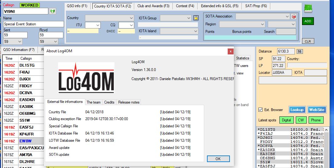

I thought I did, but now I am not so sure. Attached is a screenshot of the About page. It shows a current update for all the files, but suspiciously, the file date on the left side isn't actually populated for a couple of the external files.

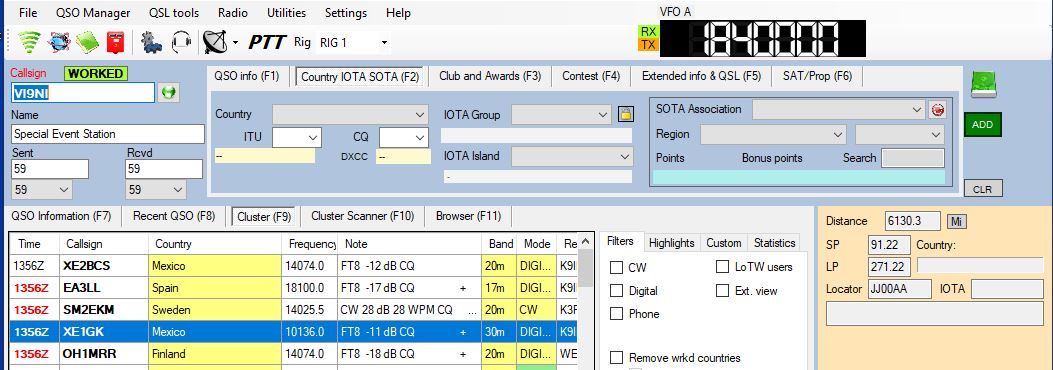

Hi Doug, thanks for the reply. When I type in VI9NI, it doesn't resolve to a country, it just leaves it blank. I have had to edit the log entry after the fact to get the country info set. Here is a picture of what I get when I just type VI9NI into the callsign field.

When I enter VI9NI it gives me Norfolk Is. I am not having the problem you are having.

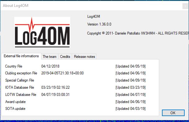

I have AutoUpdate checked, but also downloaded all the files manually again today just to be sure, then exited the program and restarted it. The problem still remains. The image below shows the program version, and file dates. Does my about screen look like it should?
Any other valid callsign correctly populates the country field. This VI9NI callsign is the only one that I see this problem with. I'm very puzzled. Any help is greatly appreciated!

Your About, External Files look fine.
