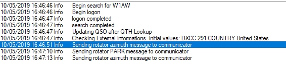

I've just entered a dummy callsign into Log4OM and here is the result of the Realtime Log showing that at least the command "Sending rotator azimuth message to communicator" is being generated. Presumably the problem lies after that.
Whilst I've had the software on my PC for ages it's only since I put up a hexbeam last week that I've been able to actually try it out, so it might have not worked from Day 1.
Jeff

- Log File 10-5-19.jpg (55.3 KiB) Viewed 6277 times
