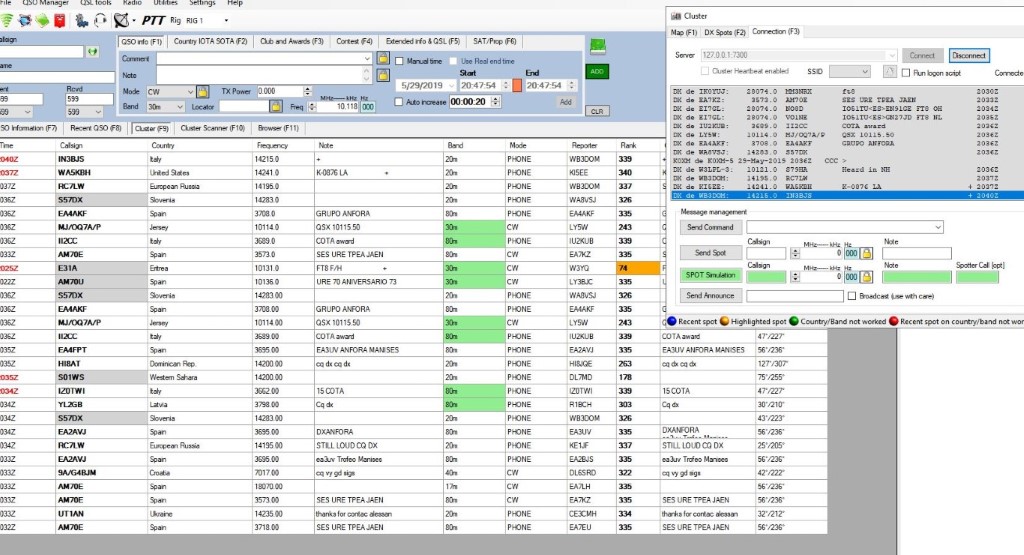

I have 2 new packet cluster up and running which I maintain. K0XM-2 and K0XM-5. -2 is running DXSpider and -5 is CC Cluster. Now I noticed the packet window in
Log4OM SHOWS spots from W3LPL or W3LPL-3, but they are not being passed to the main logging packet window. Is there a skimmer (possibly) spot lock out I am missing? I have looked all through all the settings. BTW I also have HRD and It passes them fine.

I see them in the connections window of Log4OM but not the main window showing spots (and that is with everything being passed-no filters

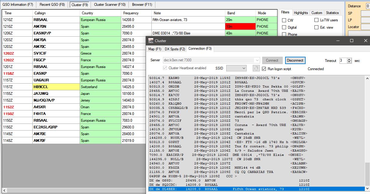

I agree there Terry, my question is what I am seeing in the attached pic. Notice 2313 W3LPL-3 is not showing on the overall cluster pic
Posts: 11587
Re: Skimmer spots blocked?
Image is too small for me to see
But I am not receiving any raw spots from W3LPL-3, see the log file I posted yesterday, everything is from K0XM-5

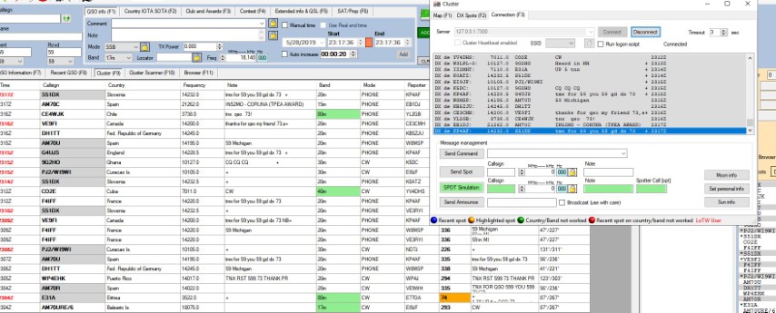

I agree Terry, I see them in the raw windows and there are not filters on for the main window but they are not showing in the main window. I took a recent pic. Hopefully it is sized better.
the 30m spot at 2036 is not showing on the main cluster window. Am I missing a setting somewhere?
