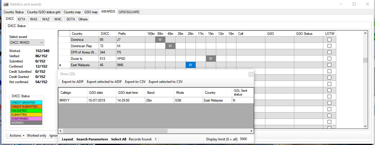

Works for Me OK see image below
Please email me an ADIF file of your logbook database so that I can check whats wrong
Send to my email address as on QRZ

Reply to Jan was as follows
OK Jan,
First thing you should realise is that N1MM does not record or export the country name nor the DXCC reference!
You did two things wrong.
1. If you had set up N1MM in the manner described in the user guide as you logged a QSO in N1MM it would have automatically been logged and the country and DXCC updated by Log4OM – See page 184 in our user guide.
2. Alternatively if you had checked the box ‘update countries in ADIF’ in the Log4OM import window Log4OM would have updated the missing DXCC references and country names automatically during the ADIF import.
Either method would have resolved the award issue, it was nothing to do with the
Log4OM country file.
I suggest that you bulk update the QSO’s in the Log4OM QSO Archive Manager following the instructions in our user guide and YouTube tutorials, using Field update and the Log Check up facilities
