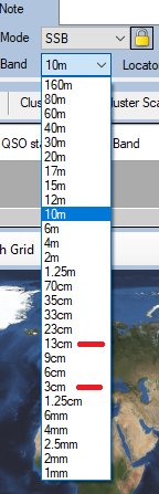

Hmm. QO 100 has uplink at 13 cm and Downllink at 3 cm and these bands are included in
the Log4OM Bandlist. You can activate these bands in the clustersettings "Settings/Options/Cat&Cluster"
and in the QSL settings for the statistic filter "Settings/Options/QSL&Labels" ......
But these bands are allways in the Bandlist as shown in the attached picture ....

Yes all configured like this but no go ;(

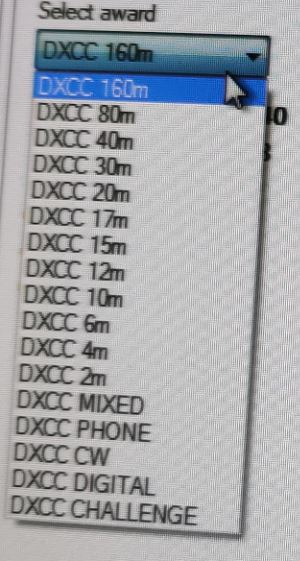

Think he will check DXCC count for satellite but DXCC only has awards from 160 to 2 m. So he
can´t check any DXCC stats.....

Do you mean ARRL/DXCC only allow 160 to 2m or that they do but these microwave bands are not included in Log4om and should be?

The bands don't appear in the stat list.

I know but are they legal bands for dxcc?
