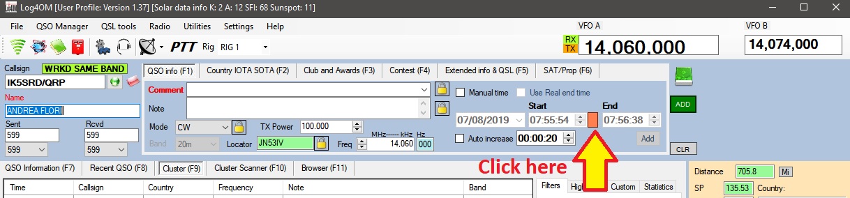

If I click on a spot on the cluster list, the QSO window is populated but the rig isn't tuned to the station. The QSO clock isn't started until I tab out of the callsign field (I do have that option checked in Settings 2). Perfect.
If I double-click on the spot, the QSO info is populated and the rig IS tuned to the station. Also perfect. However, at this point the QSO clock is started immediately but I haven'gt even had a chance to try calling the station yet, so if I do eventually make the contact I have to manually fix the start time.
I've checked all the options and setting (I think) and I haven't found an obvious way to not start the clock until I tab out of the callsign field after a double-click. What have I missed ?

Click the button alongside the time when you make the contact

Thanks Terry, I completely missed that in the manual.
