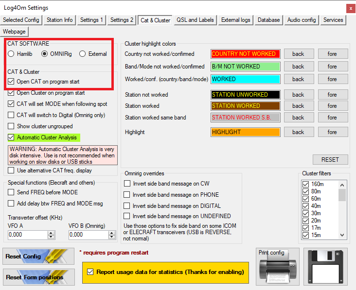

did you check the boxes for Omnirig and "open CAT on program start" in the Settings/Options ?

Yes, both OmniRig selected for CAT Software in Log4OM as is check-box for open CAT on program start.
