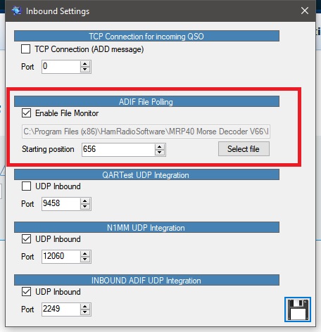

Re: Help wanted with intergrating MRP40 ADIF log
Hi Glyn,
I set up to log from MRP40 tonight and its all working fine here for me.
The path I used was C:\Program Files (x86)\HamRadioSoftware\MRP40 Morse Decoder V66\LogFiles\Contact Log\MiniLogBook.ADIF
I then logged two QSO's in MRP40 and both appeared in Log4OM just fine.
Dont forget that you must get the capital letters correct because its case sensitive.
I suggest that you set the starting possition to zero and make sure the MRP40 adif file just contains the missing QSO's to avoid duplicates, my one shows 656 after importing 2 QSO's
Here is my communicator window
