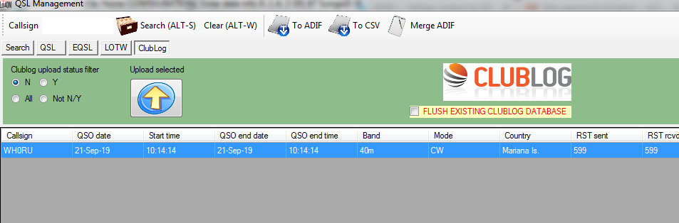

What happens is that I go to QSL Management select clublog search for QSO's not uploaded and it shows 1. There are about 6 more that have not been uploaded and can be seen by clicking ALL.
I then highlight the QSO in the pic above or all 7 if I select ALL and then click the up arrow. I get a red box stating Running.... Wait and then a second or two later the red box disappears and nothing else. I check Clublog and my QSO's are not there.
I must be doing something wrong. Bear in mind I've been using paperlogs since 1993 so be kind. Any ideas ?

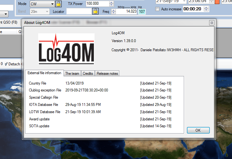

The first screen shot you posted from the 'About' menu is relevant to downloading the clublog lookup data files, it's nothing to do with uploading your QSO's to clublog.

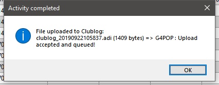

When you have selected the QSO's to be uploaded and clicked the UPLOAD up arrow you should see the following message.
If you dont you should check the log file in Log4OM which is in the help menu 'Show Log' that will detail what happened with the clublog upload, something like this at the bottom of the logfile somewhere.

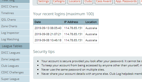

My password is correct. It does not have those special characters. I can log into Clublog with that password no dramas.
It appears to have been working up until the 13th
But I did erase and put my password in several times. Should I get an error if the incorrect password is entered? After clicking the upload arrow on Log4OM I get the red box but nothing after.

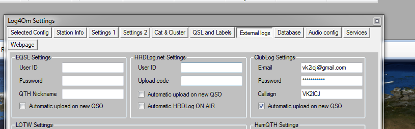

I think I have the settings right,, Do you see anything wrong?
Chris
Chris
