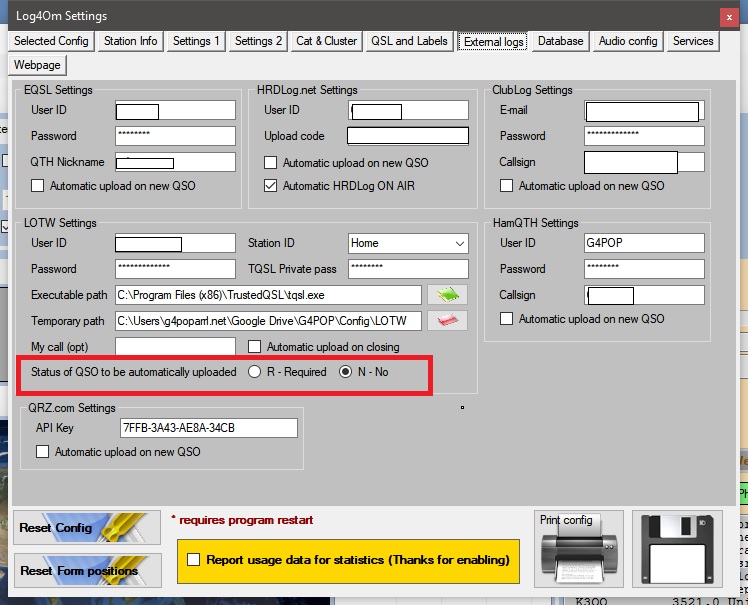

n1drs wrote: 14 Nov 2019, 19:40 I just started having an issue . After making contacts, I click QSL management the window pops up then I click LOTW and I hit select required and all the contacts that need to be uploaded would show up. I click the upload Arrow icon and be done.
But now I do it and it’s blank never had an issue before this all started after the update. So what I do now is a click search highlight all the ones that have not uploaded and then upload that way any idea how to fix?
Sounds like you have the config set wrong for selecting the QSO's for upload, check its set to requested see image below which is what I expect you will see and maybe showing the wrong setting for you
n1drs
Posts: 6
Joined: 28 Mar 2016, 00:54
Re: LOTW Contacts stop showing to upload LOTW
Post by n1drs »
Thank you Terry that worked. But now I’m getting a TQSL duplicate error from contacts from over 10 years ago about 250 of them is there anyway I can mark them is already sent to LOTW?
