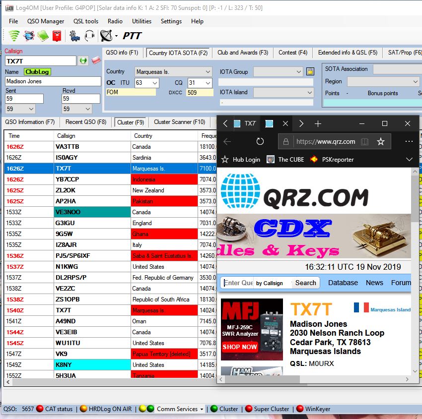

This morning TX7T is now showing as "Clipperton Island" instead of Marquesas like it had been in the DX Cluster. What changed??
Thanks,
Rory, K5CKS
