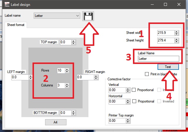

Duane,
I have no way to test this because we dont have that size paper or a printer to test with but this should work.
Dont forget to change the font size if required when printing and you will need to set margins and corrections because I have no idea what they might be

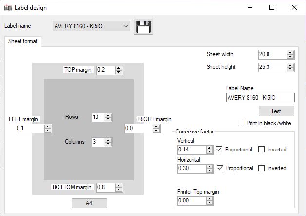

Happy New Year from the Northern part of Texas!!
Below is a screen clip of the settings that have worked (for the most part) for me and my HP M1217 MFP. The package of Avery labels I have are the 8160 version. From what I understand the only difference in the 5160 and 8160 is the type of label paper ... IE: one is for inkjet printers and the other for laser printers.
Labels are the same size.
Hope this may help out.

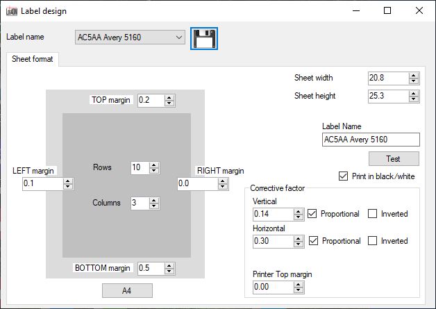

Hi Nolan - your settings worked almost perfectly. Here is what I ended up with for my Brother HL-L5200DW laser printer:
Thanks again guys. Now to fix the other issues!73, Duane AC5AA
Re: QSL Label Layout for Avery 5160 (3x10)
Duane,
Excellent. I've found I had to tweak the settings when I got a replacement printer a while back. Even though it was same HP ... Just a newer version.

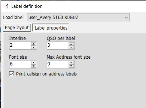

These settings work pretty well in Version 2 of Log4OM with the Canon MX492 and Avery 5160 labels. One thing to note is to make sure that the PDF printing options are not set to modify the page; i.e. it should be "print actual size".
73's de Steve, KØGUZ
These are the printer options using the Adobe Acrobat Reader:73's de Steve, KØGUZ
