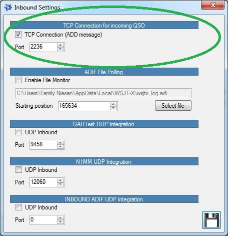

In version 1 I had a TCP inbound connection (used for GridTracker submitting QSOs to Log4OM).
How do I set that up with version 2? I only see UDP inbound settings.

TCP Inbound Connection
- TCP Inbound.jpg (63.93 KiB) Viewed 7441 times

AFAIK, TCP interface is yet to be added to V2, however I believe it is planned. Daniele can advise more on that.

It works for me. The workflow is wsjtx sending info on the gridtracker port (2237?), gridtracker broadcasting the information further (2238?), in gridtracker loging to log4om on the log4om port (2236?). In log4om I listen to 2 ports, the one broadcasted from gridtracker (2238) with the type related to wsjt messages and the one receiving information from the port where gridtracker sends the adif log (2236), type of port adif.AE0S wrote: 16 Jan 2020, 04:06 In version 1 I had a TCP inbound connection (used for GridTracker submitting QSOs to Log4OM).
