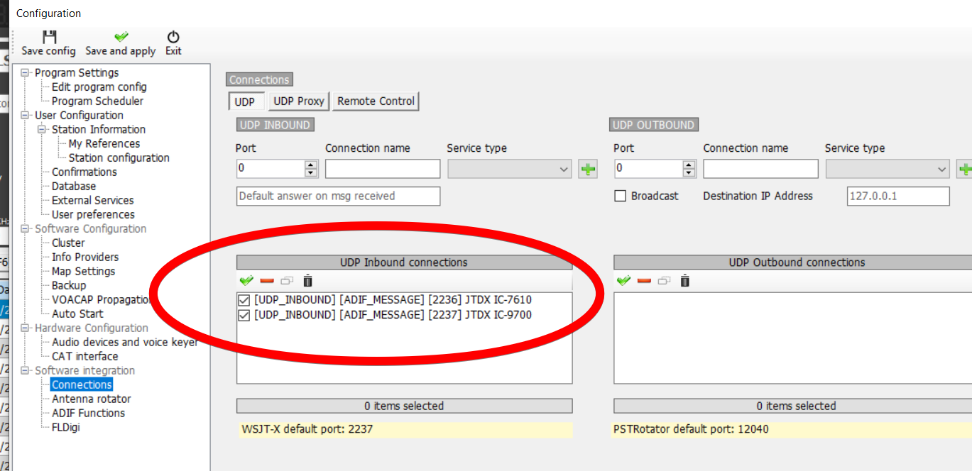

In Software integration/Connections, I have configured UDP INBOUND with port 2237, and I have checked in front of it.
In version 2 there is no more COMMUNICATOR to boot as on V1?
I made multiple tests, and nothing works. The qso made in FT8 on JTDX, when I click on "LOG QSO", they don't appear in LOG4OM2.
In JTDX I didn't touch anything, the address is 127.0.0.1, the port 2237, and I checked in Settings/reporting the boxes "Accept UDP requests" and "notify on accepted udp request".
