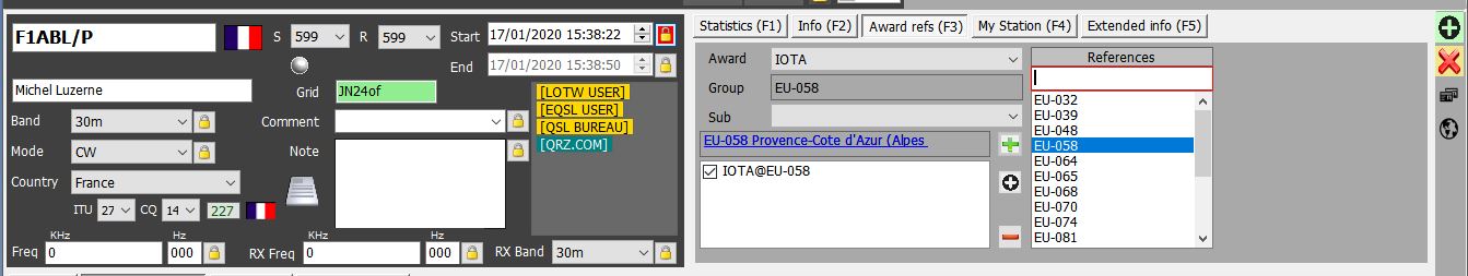

Enter the other stations IOTA ref in the input UI F3 Awards ref tab
Enter your IOTA ref in the Settings/Program Configuration/My References tab
View Award statistics and select IOTA to see IOTA worked information
