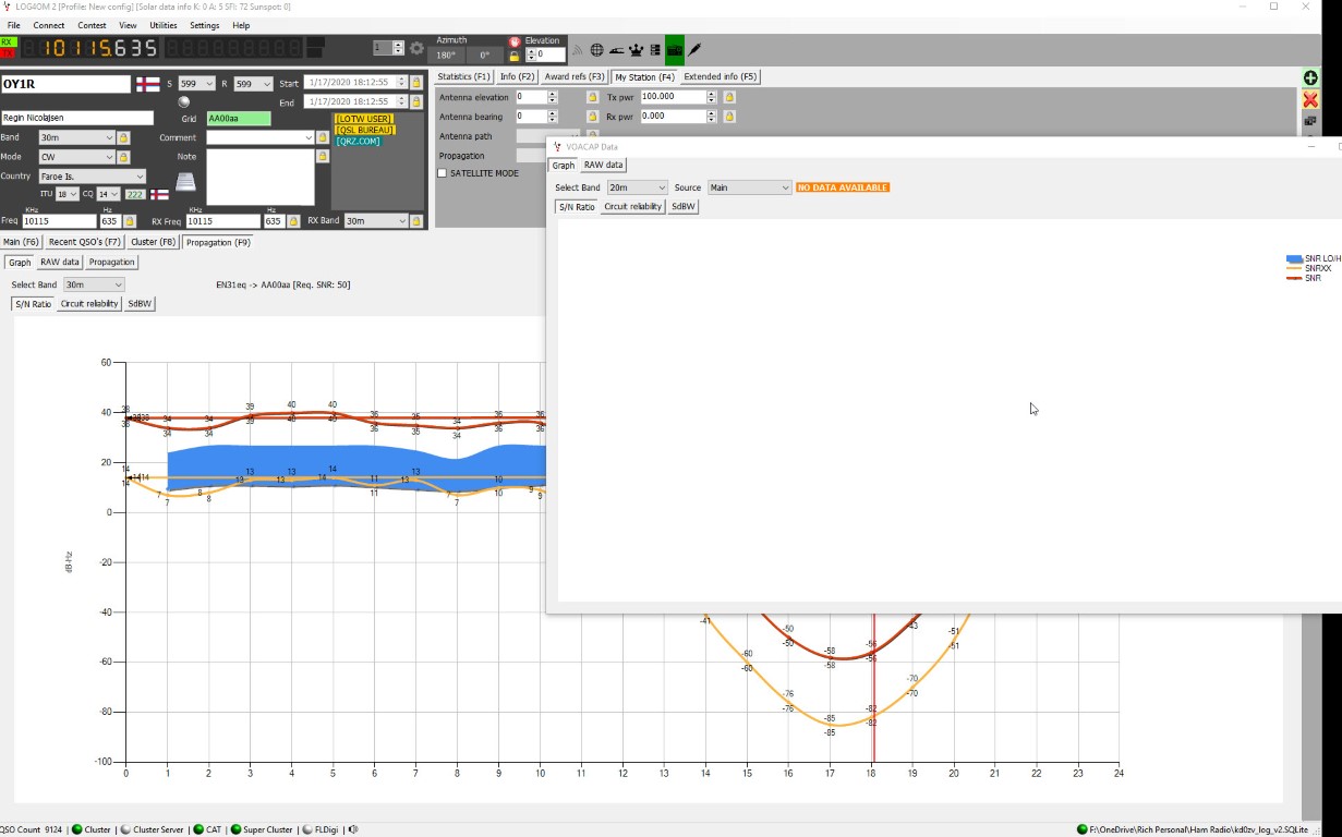

My propagation works when using the tab with F9 but if I select it from the view menu it does not work. I have tried it using Main for a source and also Winkeyer after entering a call.
Just says no Data Available.

One of the reasons I was extra confused was this.
I entered a call and checked the F9 propagation and then decided to use the window version. So I opened the Propagation window and entered the call of interest again. It did not work. You have to enter another call sign and then go back to the call-sign of interest.
Re: Propagation from View menu
kd0zv wrote: 17 Jan 2020, 23:27 One of the reasons I was extra confused was this.
This is to avoid making complex calculations on data you already have loaded. Opening a new screen will read new "events" from the main UI, it's not collecting actual UI data because the callsign could be sent to calculation engine from main user interface, winkeyer or contest screen and the form doesn't know what is the one of interest, if more than one is open
