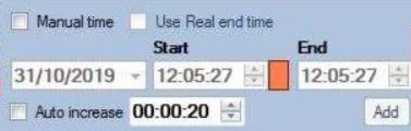

I would like to ask if there is already progress on this nice capability? I am miss that too.. looking forward to have auto increase in Log4OM v2

- auto increase.JPG (16.31 KiB) Viewed 4039 times

Thanks for reply. I just tried the lazy log. Clearly a nice feature. But i am working over Satellites an need to enter many "special" data like Propagation Mode, Sat Name, Sat Mode, RX/TX Freq, etc... So in that case, i prefer the standard log.
The time for Sat QSO's is limited, therefore i do the lazy log first on paper and log properly in Log4om2 my QSO's afterwards. Due to this fact, i need to manually enter/change the QSO start time and as for the end time, i am adding 1 minute which is the average time for a Sat-QSO. That's the reason why i am asking for the auto increase function

Usually I have only a couple of entries from a 15 minutes Satellite pass, so i am using now the lock icons next to the start and end times and add 1 minute manually to get my end time. That's the easiest and fastest way for me and i don't need to edit the QSO entry twice
