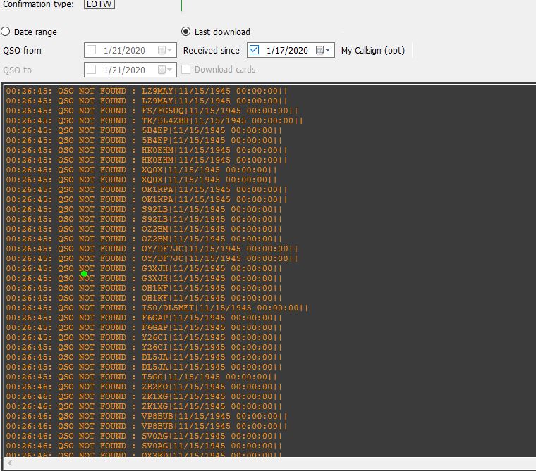

When doing a download from LoTW, an anomaly I see is several hundred downloaded QSOs that state QSO NOT FOUND, and all of these QSOs have the same date 11/15/1945 all at the same time....a bit before my time - actually a lot. Screenshot below shows one of the pages. While I have QSO'd these stations - it was not 1945.
Thoughts?
Greg/K9IG

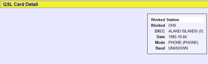

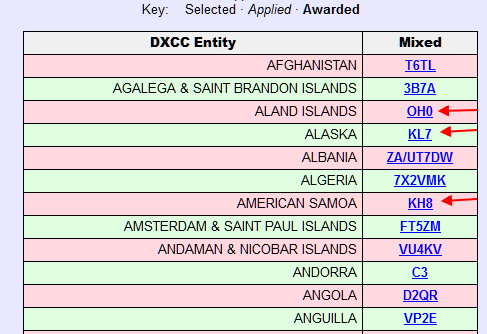

I have a similar issue, but explainable. My pre digital era DXCC award is linked to my LoTW account at the LoTW website. These awarded QSLs are stored as DXCC country, mode and date. No callsign and no band information. Parsing the information in the QSL section of the ADIF file to Log4OM result in no QSOs found.
@Log4OM_team
Can the QSO not found message for these specific messages where there is no <BAND> in the ADIF file for these records being suppressed? Every LoTW download is showing these errors.
