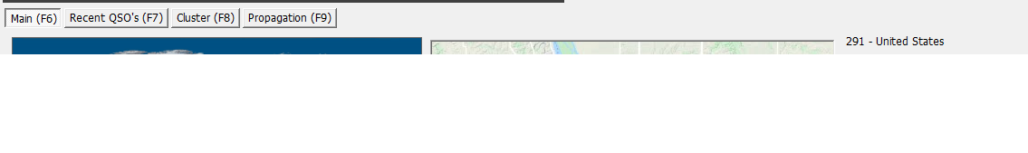

I don't have that as a tab -- it's detached (I probably did that).
Also...if you open the detached tab it doesn't show the currently selected callsign...you have to retype it again.
How do I get the Worked Before detached window back on the tab list? Don't see a "reattach" or such.

Also ... on your Main UI there are five tabs ... the last tab is: Worked Before (F10)
It is attached to the Main UI. You cannot "un-attach" the F10 Tab.

No F10 tab to be seen...
I removed the Roaming\LOGOM2 folder and still no F10 tab.
What determines the presence of the F10 tab?

Mike,
Then you need to update your V2 installation. You must still be running the very first release we did last week.
F10 Tab was added at input from users of first release.
Is the Yellow Triangle on next to the Note panel on the Main UI? Left click on that and it will show you an update is available.

Yup...had the older version....Seems that V2 doesn't check for updates?
Re: Where is QSO Information?
w9mdb wrote: 22 Jan 2020, 20:12 Yup...had the older version....Seems that V2 doesn't check for updates?
Mike,
Yes it does. I noted the Yellow Triangle in the post above and you can check the Users Guide on Page 30.
