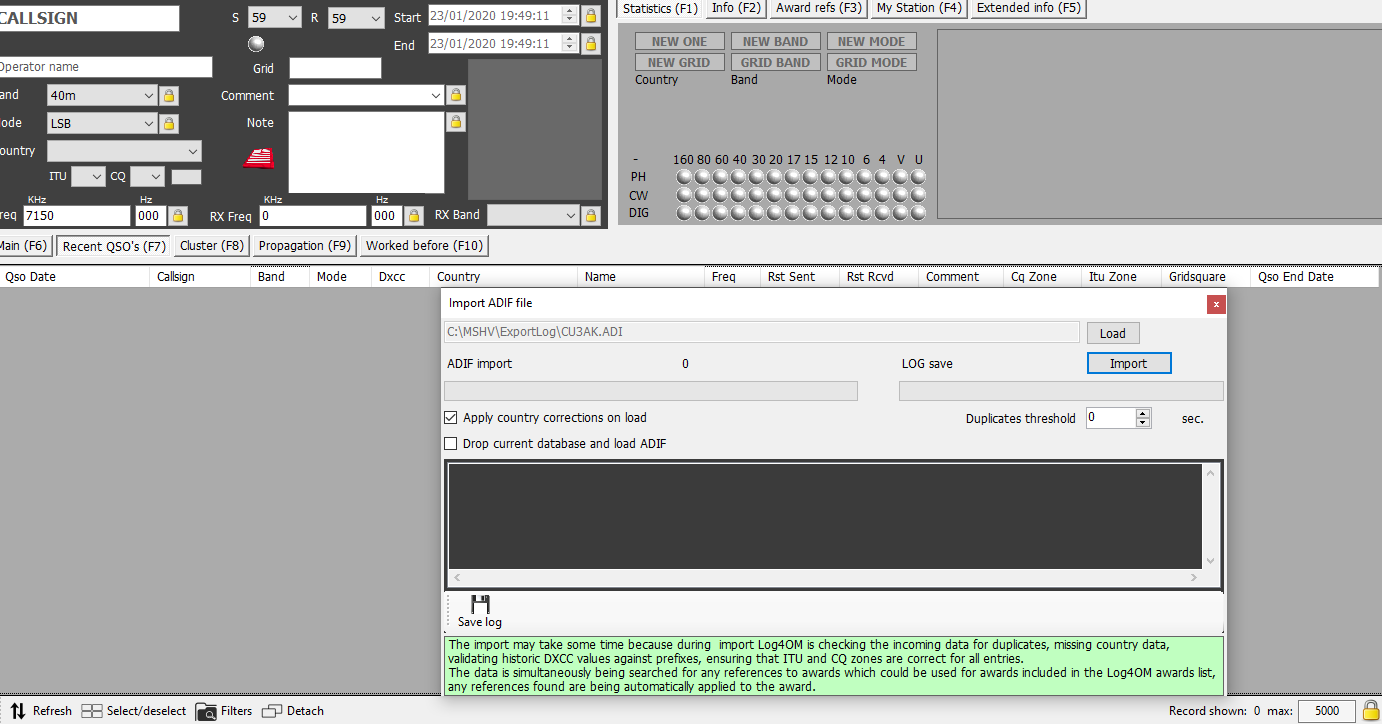

I installed the late version 2.1.0.0, create the database and in Import File, after hit the Import button it does not import my ADI file. This file was create by HRD program. How to solve this issue ?

Hello Eloy,
for the future please write topics for V2 in the V2 section of the forum. This section is
only for V1. Thank´s.
As F4GWM wrote, V2 needs ADIF 3 standard for importing ADIF logs. If you use the latest
free version of HRD it can not handle ADIF3 for export. Short trick: Download a Log4OM
V1, then finish the settings and create a new Database and make it active. Now import
the HRD ADIF to the V1. If done export from V1 to a new ADIF and check the ADIF 3 Box
in the export window. If done you can import the new ADIF 3 to V2.

Hi Thanks,
First of all sorry to post in the wrong topic, I only notice this now
I have the last version of HRD. If so, the HRD export the ADIF as v3 !!!

Should not matter what version it is we only recommend version 3 because it contains maximum data.cu3ak wrote: 23 Jan 2020, 18:39 Hi Thanks,
First of all sorry to post in the wrong topic, I only notice this now![]()
Eloy
CU3AK
I have been doing several adif imports a day as a result of support requests without issue so you are probably doing something wrong.

I'm ALMOST sure that I'm doing the correct steps. I follow the manual.

Email me your ADIF filecu3ak wrote: 23 Jan 2020, 19:54 Hi Terry,

I import my ADIF file from the EL5 (EasyLogger5) and work 100%. So the file is OK. But if you still want to check I can send it to you. It is a big file to send via email I will upload to WeTransfer. Let me know!

Sorry, what I meant to say is that:
I was able to import from the EL5 log the ADIF file 100% (export from HRD)
But still not able to import from Log4Om2 the ADIF file (export from HRD)
One program works 100% with LOG4OM2 does not work
