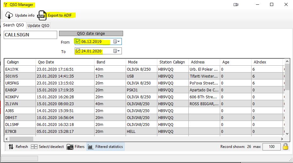

Not sure how to do this,but can i export certain logs from a certain date period :D

I had the same issue downloading the logs for a given period. yes and i found it can be achieve by QSO Archive. however i need to add more fields on to the download. eg: DXCC info etc.
is it possible to add new fields to download???

Ras,
Choose ADIF Level 3 as that provides all the possible data available for export. ADIF exports / imports are kept within the standards allowable by the ADIF rules/regulations.
