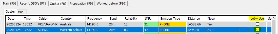

Might not be related to any issue in Log4OM, but still curious to find an explanation.
I came across a Cluster Spot today of S01WS indicating this call to be a LOTW user.

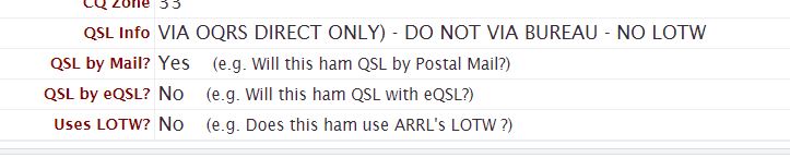

His QRZ.com profile clearly indicates that he is not an LOTW user.
There must be an error somewhere in the data chain.

Lastly the info on QRZ, or whatever page, may be outdated.

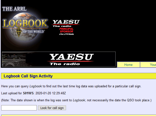

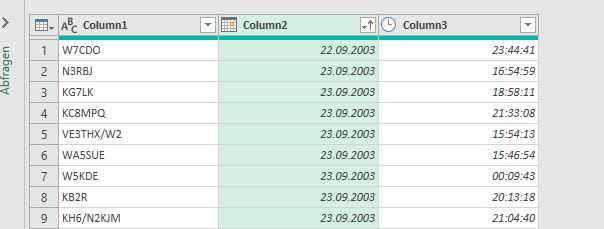

some rather old entries in the lotw.txt which is downloaded from LOTW
But it seems not every call in lotw.txt is automatically considered to be "LOTW user" by Log4OM. I just did a test with spot simulator
Just trying to understand the internal mechanism behind that :-)
