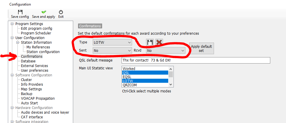

Hi Mike,k3maw wrote: 27 Jan 2020, 19:56 I have read, and still read, the manual. I like the V2 a lot; it's a major upgrade. I understand that log4om only uploads to Lotw on shutdown, but when I changed the default value of "LOTW sent" to ="No", they were not sent upon closing. I changed the default value back to "Requested" and it works.
Let me explain. There are two factors which need to be accounted for. The first is your setting in Configurations, Confirmations tab. It controls what the defaults are for each type of confirmation - LotW, Clublog, etc. for the Sent and Rcvd fields. I use (my personal preference) "No" for both Sent and Rcvd fields. Image below.
So in that case, all new QSO's will be written with "No" in the LotW Sent and Rcvd fields.
The problem you are experiencing is because your older QSO records were written with "Requested" in the LotW Sent field, but now you have changed the criteria to "No". So it will pick up only those QSO's with "No" in the Sent field, ignoring those with "Requested" in the sent field.
The cure: Change all your records with "Requested" to "No" in the sent field. This can be done by enabling "Update" in the QSL Manager window, selecting all records with "Requested" in the Sent field, and changing them to "No". Then make sure your default Sent is set to "No" above.
