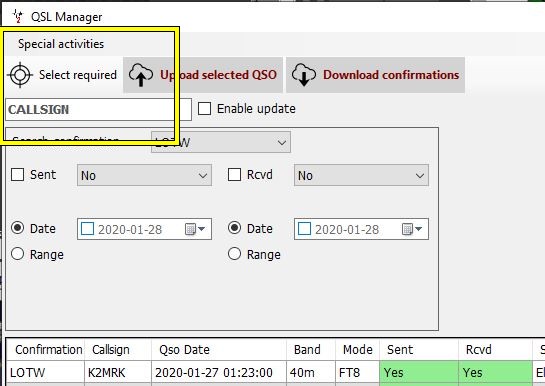

The LOTW Upload in V2 is far too many clicks compared to V1 and horribly non-intuitive.
#1 It doesn't remember the Sent status or Sent checkbox that one uses on every upload (Requested in my case).
#2 Apparently the Sent status field isn't indexed as the search is very slow
#3 Having to click Select/deselect, then Uplaod, then another Upload button is overkill.
It should be a one-button shot. Remember the Sent/Requested settings, automatically select all, and the Upload Selected QSO should do what it says and be done with it.
Posts: 1951
Re: LOTW Upload
Mike,
You must not have tried the "Select Required" button for uploading Q's ?? Give that a try and see if that will remove one of your keystrokes.

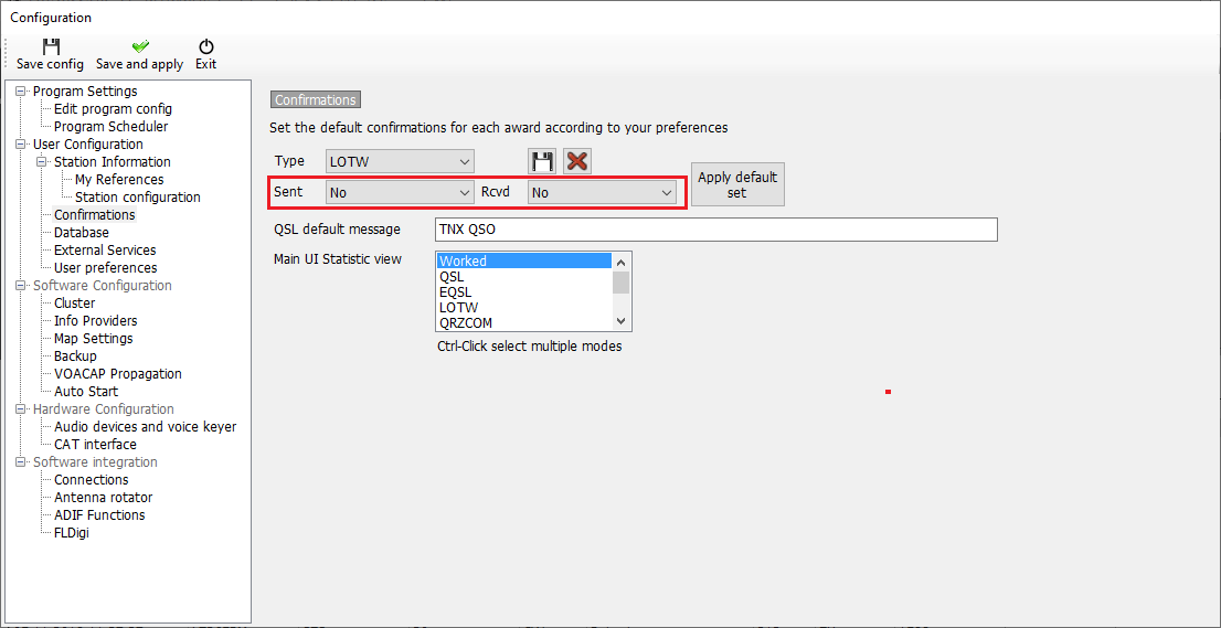

Re: LOTW Upload
What are your settings in the Confirmations screen ? Mine was set to "Requested" first and auto upload don´t
working. Now set it to No/No and all looks fine. Have you enabled Auto Upload on Close for LotW in the external
services ?

Re: LOTW Upload
Yes i do .... only for QSL i set it to requestet to have a search facility to find QSO´s for label printing. :mrgreen:
