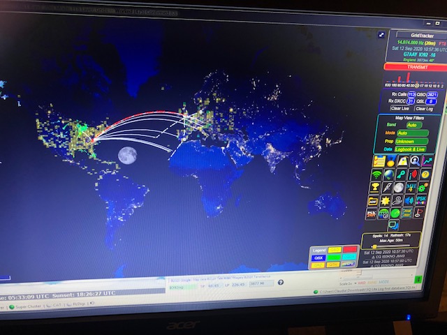

NI4TG
Posts: 7
Joined: 29 Apr 2020, 20:37
Re: GridTracker
Post by NI4TG »
Log4OM 2, WSJT X, and Gridtracker (night view). The instructions on the Gridtracker site under media are great.
