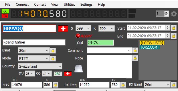

So it is my understanding LOTW users lose the Log4OM flag when they have no uploaded in a year.
What happens if someone is a new LOTW user and has not used it yet?
Example below. DXpedition. LOTW says station has never uploaded a log.
Log4OM has conflicting info. Shows LOTW user by their name but the cluster does not indicate that.
HB9VQQ
Posts: 237
Joined: 16 Jan 2020, 21:19
Location: Switzerland
Re: LOTW flag??
Post by HB9VQQ »
I believe yellow is from your Primary Info Provider and the cluster flag is from LOTWList.

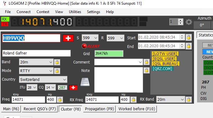

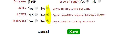

Re: LOTW flag??
Post by HB9VQQ »
I changed my info in QRZ.com to No.
This is the result in LOg4OM.
This pretty much proofs that the lookup of EQSL and Bureau QSL is derived from my primary info provider which is qrz.com
