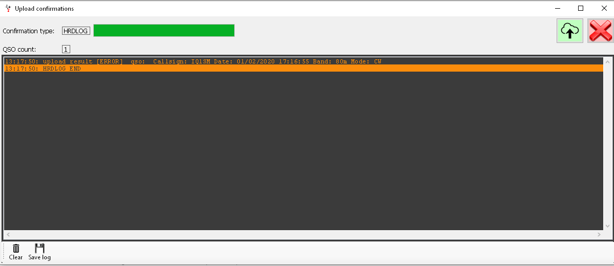

Screenshot (6).png (15.65 KiB) Viewed 7084 times
N3XL,
I have check the three the boxes you wrote, but nothing has changed. However when I use Log4om on the HRDLOG site I am "ON AIR" without having checked "Automatic HRDLOG on air" on Log4OM. I tried to upload from QSL Manager but the one in the photo is the result:

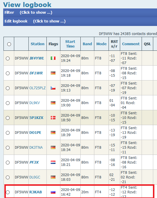

Re: The external service HRDLOG.net is not working properly.
As i said, i have checked all send status to "NO" except paper "QSL". Sometimes there´s a problem
that HRDlog.net send status showing "No" but at my end all contacts are stored at the HRDlog site ....
Please see my screenshots ....
