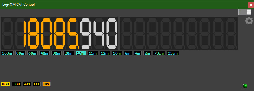

This is my first logging program and I am really enjoying it. I do have another question, I looked in the manual on pages 20-23 but do not find if I can move the large cat screen around the screen.

Yes just drag it in the normal windows manner

When I bring that up it shows me the modes for both Radio 1 and Radio 2
When I change to Radio 2 it shows no mode. Come back to Radio 1 and no modes anymore there either.
Running Omni Rig and Flex 6600 with Rig 1 going to slice A and Rig 2 going to Slice B and both are on different Serial ports.

Still the same with 2.3.0.0

I just upgraded the software and no change.
Here is an example.
I opened the large window, did a video capture, tuned the rig which is slow to respond but no big deal. Changed rigs (slices) and changed back.
Then closed the window and reopened it so you could see it from the start.
https://vimeo.com/389047745
Re: Large CAT screen
Ok i have seen the video. Investigating. Probably on VFO change i'm not asking mode again to the rig.
checking, thanks for heads up

It works correctly if you change Rig in Main UI but not in large CAT Control window.
