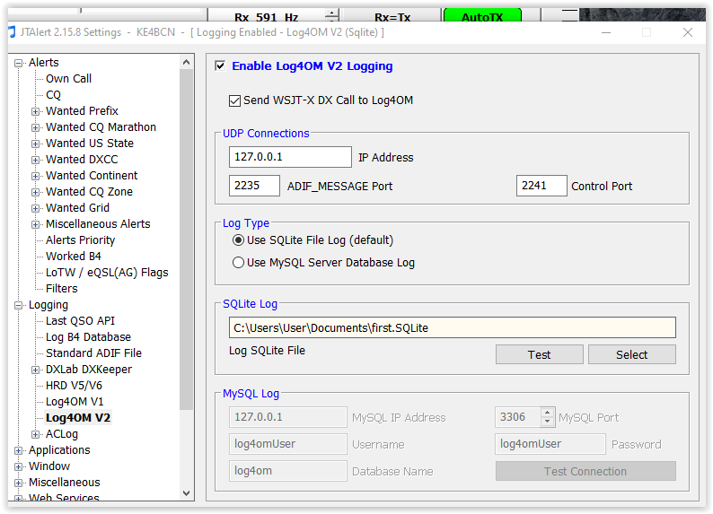

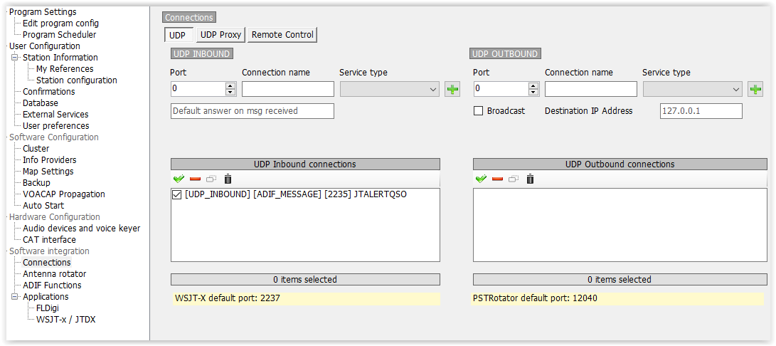

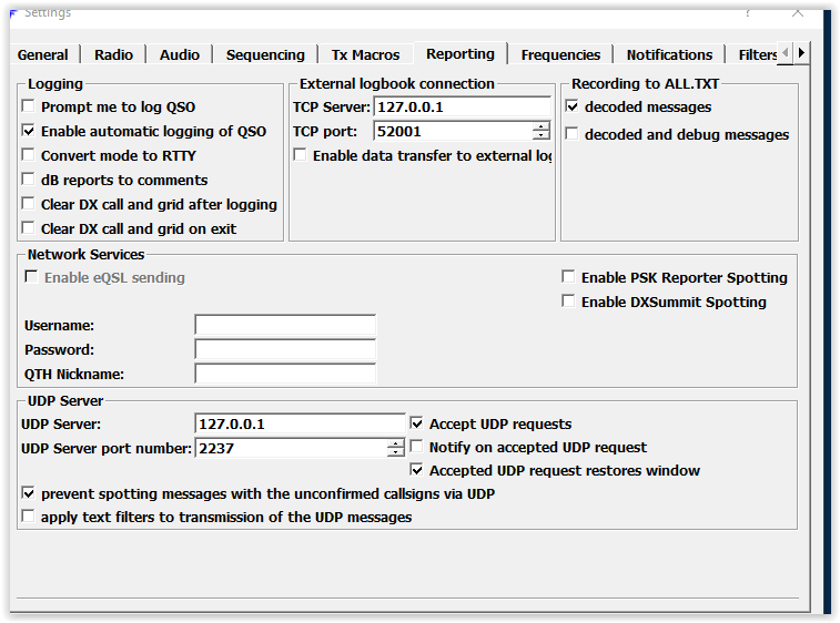

Just installed lastest version. Having several problems with jtalert. I have same settings I had with version 2.2.0.0. I checked the new option for jt but it is unchecked. I have been getting lockups and if I do get it to log in log4om it does not clear the callsign field. I reinstalled version 2.2.0.0 and all is well. Is there something that has changed? I have read the release notes.

Ross,KE4BCN wrote: 03 Feb 2020, 20:07 Just installed lastest version. Having several problems with jtalert. I have same settings I had with version 2.2.0.0. I checked the new option for jt but it is unchecked. I have been getting lockups and if I do get it to log in log4om it does not clear the callsign field. I reinstalled version 2.2.0.0 and all is well. Is there something that has changed? I have read the release notes.
Please post screenshots of your V2 Configurations (with the latest release), Connections tab. And your JTDX Settings, Reporting tab. And your JTAlert Settings, Logging, Log4OM V2 tab, and the Applications, WSJT-X/JTDX tab.
This will be beneficial in trying to help you out.
Re: Release note – Version 2.3.0.0
Ok here are a few snap shots. In version 2.2.0.0 when a callsign was logged or you cleared the callsign in jtalert it would clear the callsign in log4om. In 2.3.0.0 the callsign never clears unless you clear it yourself. Lockups seem to have cleared up after a few reinstalls..
OM,
Try this:
1. In the JTAlert settings, Log4OM V2 tab, uncheck the "Send WSJT-x DX Call to Log4OM.". We recommend you use the Rebroadcast method for better performance. We need to correct that in the Log4OM User's Guide.
2. In JTAlert settings, Applications/WSJT-X / JTDX tab, set the Rebroadcast settings per page 142 of the Log4OM User's Guide
3. In your Log4OM V2 Configurations, Connections tab, create a Port 1240 JT_MESSAGE connection for Rebroadcast. This is on page 140 of the Log4OM User's Manual.
4. In your Log4OM V2 Configurations, Connections tab, Remote Control tab, make sure you have enabled Remote Control on port 2241 - per page 140 of the Log4OM User's Guide.
5. In your JTDX Settings, Reporting tab, UDP Server section, check all three options to the right. Your middle one is unchecked. Again, see User's Guide on page 141.
That should give you better performance.
BTW, logging of a QSO via JTDX and JTAlert does not clear the callsign from the Log4OM main callsign field, as the callsign is still in the DX Call field of JTDX... But if you clear it from JTDX, it should clear from Log4OM. It does on my setup running 2.3.0.0.
