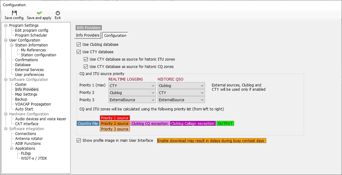

To get back to the original topic, I just tested some kG4XXX calls using actual calls. Almost all of them show as Guantanamo Bay, even though they are located in the US. The one exception is KG4W, which displays correctly as US. I updated the country file and restarted Log4OM, and still getting this result. I have attached a screenshot of my configuration.
Jim N6VH
Jim N6VH
- Info Providers Configuration.jpg (246.88 KiB) Viewed 4927 times

Jim,N6VH wrote: 09 Apr 2020, 17:34 To get back to the original topic, I just tested some kG4XXX calls using actual calls. Almost all of them show as Guantanamo Bay, even though they are located in the US. The one exception is KG4W, which displays correctly as US. I updated the country file and restarted Log4OM, and still getting this result. I have attached a screenshot of my configuration.
Jim N6VH
I have just updated the country file and our configurations are the same. However, I can't find any KG4 2x1 or 2x3 call that shows Guantanamo Bay. I have checked all of the 2x1 calls and they all show United States and DXCC=291. I've also checked many 2x3 calls (not all of course) and haven't found one there either.
There is a setting under User Preferences that reads Overwrite User Gridsquare in Main UI. If this is unchecked, the gridsquare will get "stuck" on the first valid lookup that is done. For example, if you key in KG4AJ it will correctly show DXCC=105 and Guantanamo Bay as country but if you just backspace the J so you have KG4A, it will stay stuck on gridsquare FK29kw and the right map will still show Gitmo although country will be correct and DCXX will also change to 291. I consider this to be incorrect and have written it up in another thread but that is another story. It's important to backspace through the call to get to KG4 and then wait until the grid clears. If you do that, KG4A gridsquare will change to the correct FM08rv in Woodstock, VA. Maybe not the issue but it can make things very confusing. Checking the Overwrite gridsquare box eliminates this behavior.
So, how are you determining that the calls all show Guantanamo Bay? I can't find one by just keying in random calls.
73 - Tom NS8K

Thanks for your reply. I checked the Overwrite User Gridsquare, and that didn't change anything. I also tried running Log4OM as administrator, also to no effect. I have entered various KG4 calls, using calls I know are in the US (I have already worked them), and of those I entered, only one came up as US (the one I already mentioned, KG4W).
Jim N6VH
Jim N6VH
