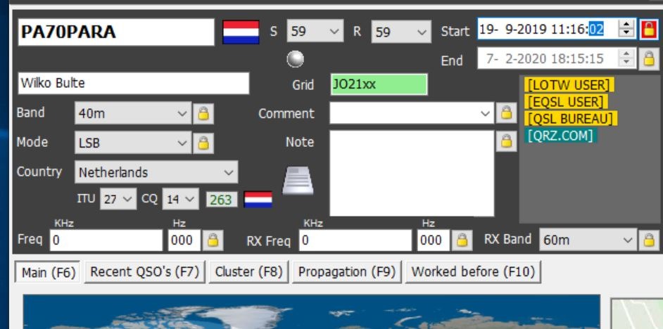

I am trying to enter QSO's from my old paper log. But it appears to be impossible to enter qso's at 144 and 432 MHz. I also find it difficult to enter an old date (1972)

Are you using the padlock to the right of the date and time fields

Yes I did open it. And next step add the date and time as text.
Re: Old qso's
PA0AER wrote: 07 Feb 2020, 17:32 Yes I did open it. And next step add the date and time as text.
Please explain in detail step by step what you are doing and where you have a problem so that I can better understand

First I stop the radio (no longer information from the CAT to log4om)
then I enter the information from the paper logbook
last, I have to enter the date and time, which takes the most time (I have to enter more than 1000 QSO's)
this is how i did it Image
Re: Old qso's
So are you saying there are no VHF/UHF bands in the drop down menu?

that is problem 2
Re: Old qso's
PA0AER wrote: 07 Feb 2020, 18:46 that is problem 2
This is the second time I have come across this, we are trying to find the reason.
Could you help by emailing me a support request to g4pop (at) arrl.net please, it's in the help menu
