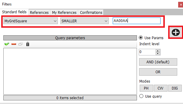

Re: Distance
What you can try at the moment is to use a filter in QSOMgr which showing you all contacts with an empty
"My Grid Square" field. Filter is "MyGridSquare " "SMALLER" "AA00AA" and hit the + icon. Now all your contacts
will be listed which have an empty "My Grid Square". Now you can select the contacts you like to bulk editing
and give them your original Grid.
If done so and V2 has been updated all contacts which including both locators should show a calcilated
distance (i hope).
distance (i hope).
