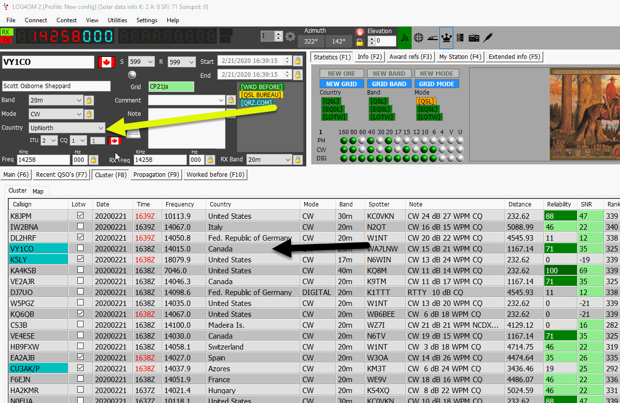

Re: Country look up
As a FYI after a country file update the info in the QSO entry area does not update right away.
To prove this I went into the Country File XML and changed Canada's name to upnorth.
They were showing up in the cluster as upnorth. I forced a new country file update and they started showing up as Canada immediately in the cluster but when I clicked them they still showed up as upnorth in the QSO box until I restarted Log4OM

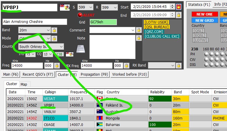

Re: Country look up
Terry,
My question is not in regard to a NEW ONE it is why it is marked as Falkland Is in the Cluster F8 grid but as South Orkney Is up top?
(In regard to NEW ONE - If I filtered the cluster grid to show only new ones, I would not have seen the spot at all because I have worked Falkland Is. and therefor I would have missed an actual new one, South Orkney Is. At least when they get on the air tomorrow).
Mike
Mike
Re: Country look up
Mike by the way mine is reporting it the same way.
The country.xml file has VP8 listed as Falkland Is and VP8O as South Orkney Is
Re: Country look up
Cluster checks prefix against country file but inserting call in input field does a deep search of all lookup facilities including QRZ, Clublog etc so it gets a better match.
Re: Country look up
Terry,
That is interesting.
Here is my setup
If I use Mikes VP8PJ as an example it shows up as Falkland Islands in the Country File. But if you look them up on QRZ.com they show up as South Orkney.
So just trying to under how the logic works. Why would it choose the 3rd choice (external source) over the Priority 1 (max) in the "deep search" you mentioned.
Here is my setup
