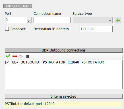

Thanks Nolan...I've already seen all of those posts. The bulk of those are really only from 2 different threads; mine and one other.
I am currently using the settings from the post that is NOT mine:

Rich,W4ATX wrote: 26 Feb 2020, 01:30 Thanks Nolan...I've already seen all of those posts. The bulk of those are really only from 2 different threads; mine and one other.

You noted above that you are using settings from another post. Does that mean that you now have communications between Log4OM V2 and your PSTRotator?
RE: V1 Communicator has been replaced in V2 by Configuration / Software Integration / ...... You will find a section there for the PSTRotator.
As for WSJT-x driving the PSTRotator ... NO ... You set Log4OM V2 up to communicate with PSTRotator. You utilize the Connections and possibly the WSJT-x / JTDX sections to set up those APPs and also JTAlert if you happen to use that APP as well. Directions for connecting those APPs starts on Page 144 of the User Guide.

>>>>>You noted above that you are using settings from another post. Does that mean that you now have >>>>>communications between Log4OM V2 and your PSTRotator?
Sorry, no communications yet. I showed those settings as what the other fellow had used to get his working. Still no joy on my end. You answered most of my questions as to how it *should* work... I will continue searching/trying.

OK, I am beginning to think that *maybe* I just don't understand the integration and how it is supposed to work. I was never able to find any documentation in the V2 manual that covered this. Version 1 manual gives a couple of items almost as a side note but not complete (in my opinion).
I stumbled across this while trying to understand: If I have a call sign loaded into LOG4OM and then click on the azimuth number shown, that azimuth is transferred to PSTRotator.
The rotator still does not activate...I still have to click "Go" in PSTRotator. Is this all the integration is supposed to do? I was expecting something much more automatic, as in once a call sign is loaded the antenna is turned to the proper azimuth. Am I way off base here? Is there some documentation that fully describes this?
