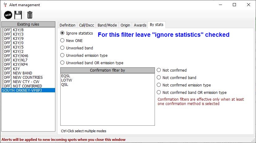

It's working now! I just changed "New one" on the left side of the "By stats" window to "not confirmed band or emission type" on the right side.

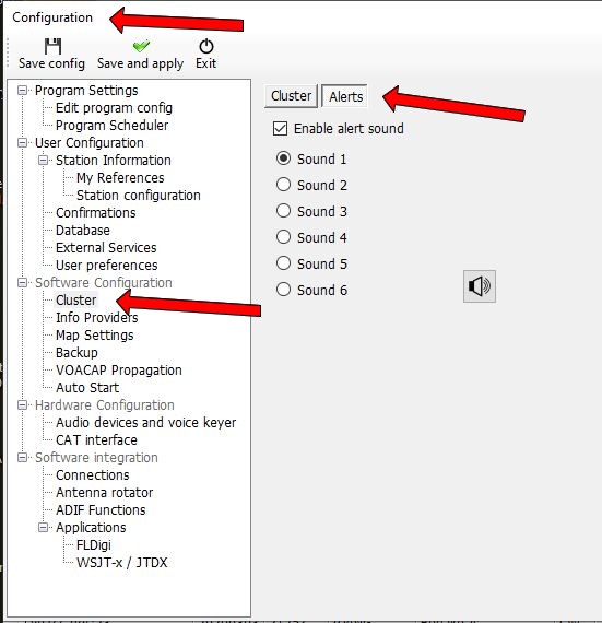

Bob,
When you are at the Main UI click on: Settings / Program Configuration / Cluster / Alerts --- That is where you can enable the alert sound and test a few different sound wav files that are included. Tic the Sound 1, 2, 3 ... etc.. and then tap the speaker cone to hear that wav file. You must also tic the Enable alert sound else there will not be any sound.

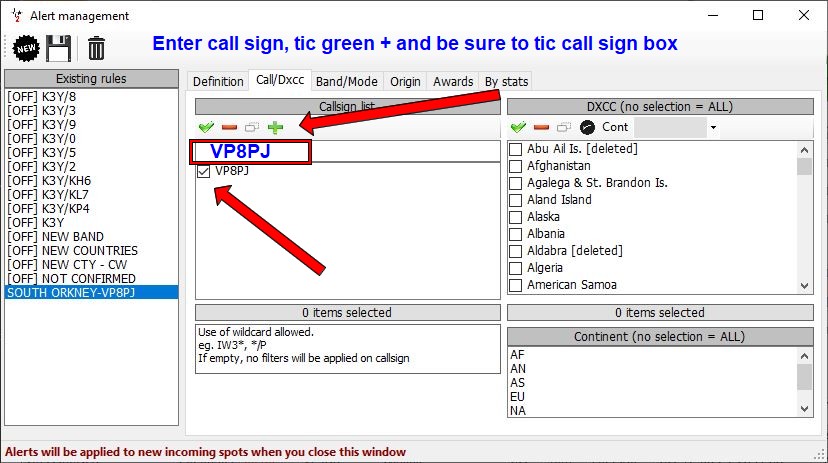

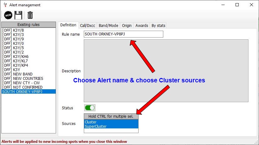

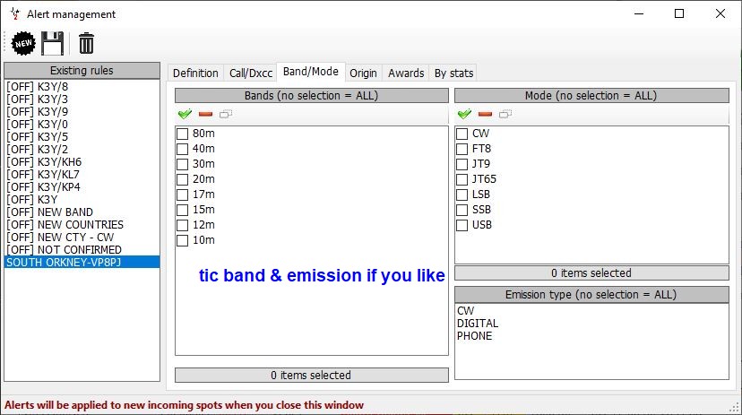

Bob,
OK ... now your question has been made more clear. I have also set up a very simple Alert for VP8PJ. I have it alert me for all modes on all bands. Very simple. Start at: Settings / Alert Configuration and then select the "new" button and begin entering your items for the alert.
You can copy what I have in my Alert (images below). You can click on the Band/Mode Tab and also tic 30m and CW to add more filtering. Once you get things set click the floppy disc save button. Make sure that your new filter status is clicked to Green. Also be sure to select your Cluster Sources and save with your initial configuration for the alert.
The User Guide instructions for Filtering alerts starts on Page 52 of the most recent version.

I see the images posted with the first/start tab at the bottom of the 4.
