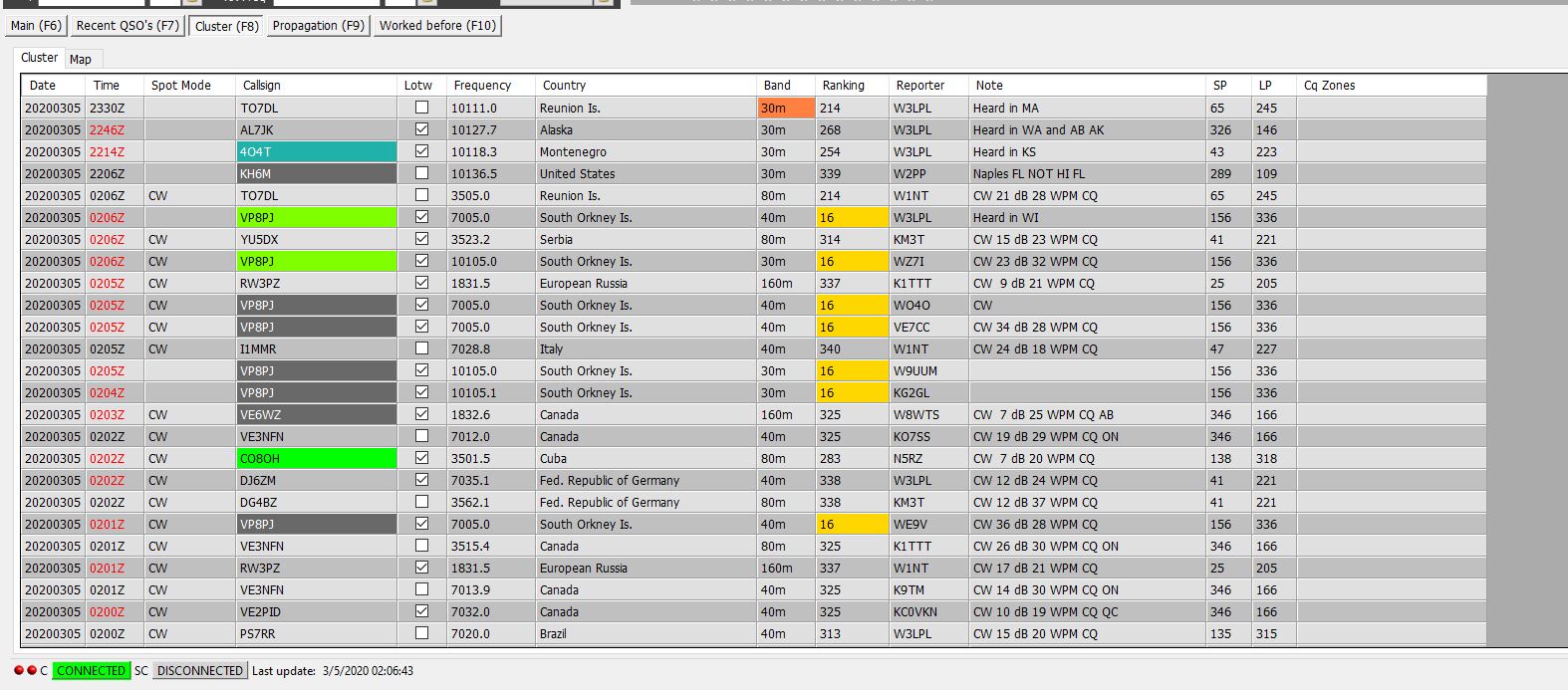

Some timeout? This has happened a couple of times. Look at the time column.
Chuck K0XM
Am I missing a setting cluster?
- Cluster Window.JPG (235.73 KiB) Viewed 7980 times

No actually as a cluster sysop, I have it running constantly. This screen shot was after a restart of Log4om to see if it would clear, and I have all the startup scripts in L4OM turned off. Log4OM telnets into CC User which handles all my log in/log out and telnet interfacing along with any start up scripts. The recent spots were updating under the incorrect ones, and thats what was weird. And it has done this a couple of times before.

Yes, I tested it with a direct connection to the cluster I own and run and same thing. It showed the "retained" spots. They eventually cleared off but it took a few hours. It is NOT the cluster or CC User. I am just wondering if I missed a setting. It is not a show stopper but just want to make sure it is not operator error.

I figured it out. Since I have CCUser doing all my login scripts, I had to edit the defaultclustercommands file to remove the script frm Log4OM log on. I was mistaken and apologize if I was in error earlier.

My issue was, there is a startup script in L4OM which runs every time you log in. If you are behind VE7CC user, it will pull OLD spots and retain them for an hour or 2. I remove the log on script (basically SH/DX/30) from the cluster script and all is ok.
