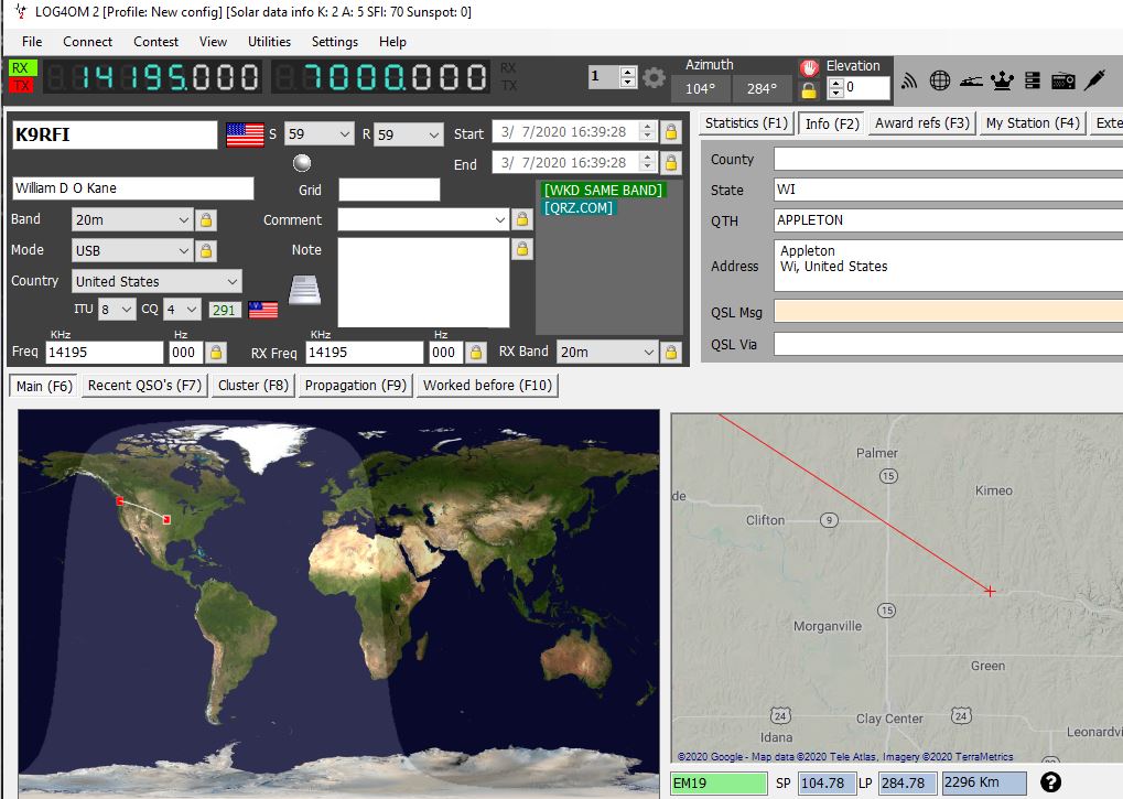

I've noticed many times the world map and zoomed in map to the right of it on the Main screen do not show the correct location of the contact being made. My QTH is shown correctly and if I clear the contact, it will clear the map and only show my location but if I input another call sign, it just puts a pin in the center of the US with a line to it even though the contact is elsewhere. I am running 2.4.0.0.

I've attached an image of what I am seeing. The contact is in WI but it is showing the center of the country.
I have QRZ as my Primary source with HAMQTH as my failsafe. I do not have a paid account on QRZ. Could that be my issue??? I do have accounts on QRZCQ and HAMCALL. Am I better off changing that around?

Shame on me ... I should have also asked that question about the "paid" QRZ account for the additional data at the XML level.
Switch your prime & backup to make HamQTH "prime". No fees for their data and "in most cases" will help better drill down ... at no charge.
If V2 can't find the data in either of those sources it will default to the country file which points to center of USA.
As for QRZCQ and HamCall ... yes, give them a go and especially as you have accounts with them and see what you get. I don't happen to have accounts with either of those so can't directly test/observe.

Hi Rich,
if you take a look to the data in the main UI you´ll see that there´s no
grid for the worked station. If there´s no grid Log4OM will display the
center of the worked/logged country. Don´t know what you have setted
up as external sources but if you have qrz.com you need a payed xml#
subscription to receive a grid. Same we have at qrzcq.com. One of the free
services ist HamQTH but users have to provide and updating their data.

I decided to give that a shot and it works like a champ! Thanks for having me look in there.
