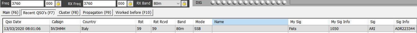

I have just exported a QSO from version 1 which contained the following information
My Sig
My Sig info
Sig
Sig info
All four values were correctly imported into Log4OM version 2 see screen shot below
1. Are you sure there are SIG values in the export
2. Did you export as an ADIF version 3>>>
3. Have you selected the SIG fields to be displayed in Log4OM V2

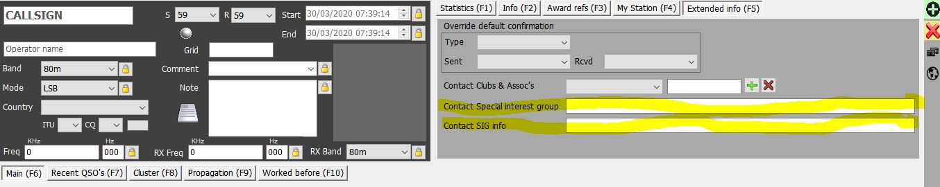

I do not know how to display SIG fields. I was able to view the QSO grid and the SIG/SIG Info fields show but I cannot enter data into them.
I have only entered 1 QSO into V2 and did not do any more as there were no SIG/SIG Info places to add the data,
Next release
