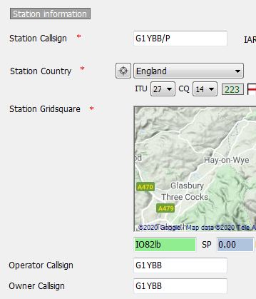

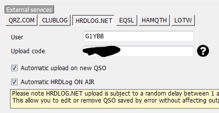

I am testing in a portable user configuration. In settings I set callsign as G1YBB with upload code, as I did in v1.x. In the trace log I can see Log4OM is sending G1YBB/P with my upload code and hrdlog was saying unknown user.
I have found that I can only log into HRDlog using my base callsign and password, so I assumed the same happening here.
Sure enough, I switch to a fixed station profile with no /P suffix and HRDlog is happy.
So in the portable configuration while I am entering my correct upload details Log4OM is using the station callsign details instead of the user details to try to upload.

You can see in the PDF that my settings for v1.41 and v2.4 are the same, but in the tracelog above v2.4 is sending
Callsign=G1YBB/P&Code=**********&App=LOG4OM
and on HRDlog only G1YBB works with the upload code.
