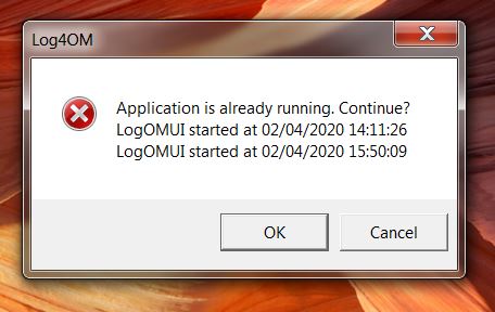

Please help me, I want to upgrade to version 2 but today my LOG4OM version 1 will not open or load.
It only goes into a window like this
download/file.php?mode=view&id=3295
It reads: LOGOMUI Application Already Running ? continue
I click on ok but all it does is close the window but never opens the program, I have waited for an hour. I want to get it running to export my log. I have looked at Program Manager and it is not shown as running. I have re-booted and left it for hours to cool but still no luck. Any advice I how I can get LOG4OM 1 to run would be appreciated.Or is my log lost for ever?

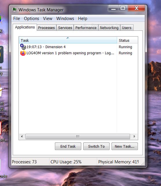

I thank you for your speedy reply I tried to reun the program again but no luck. I checked task manager and it showed this fault >>
Capture task manager.JPG (66.02 KiB) Viewed 4209 times
If I download a new copy of LOG4OM version 1 will it correct any damaged files and save my log? Sorry to be so thick but computer programing is not my forte I just drive them hi.
Again my thanks and appreciation for your help in these testing times. 73 Glyn GW0ANA

Click on the log4om line to highlght it then click end task
Download and install the latest version of Log4om
However when you have unzipped the download file you must right click on the unzipped file and select 'run as an administrator's
Complete the install and let us know how you get on
