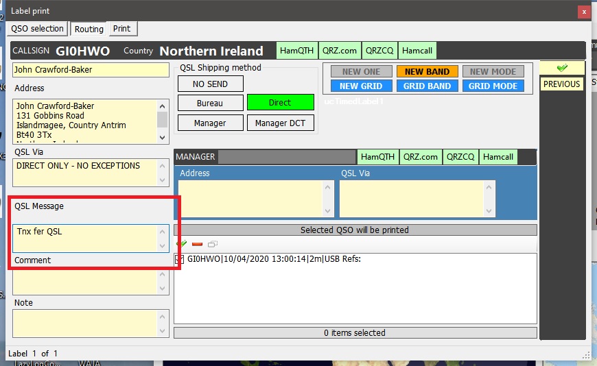

You can add what message you want but at this time the Pse QSL cannot be changed or removed.

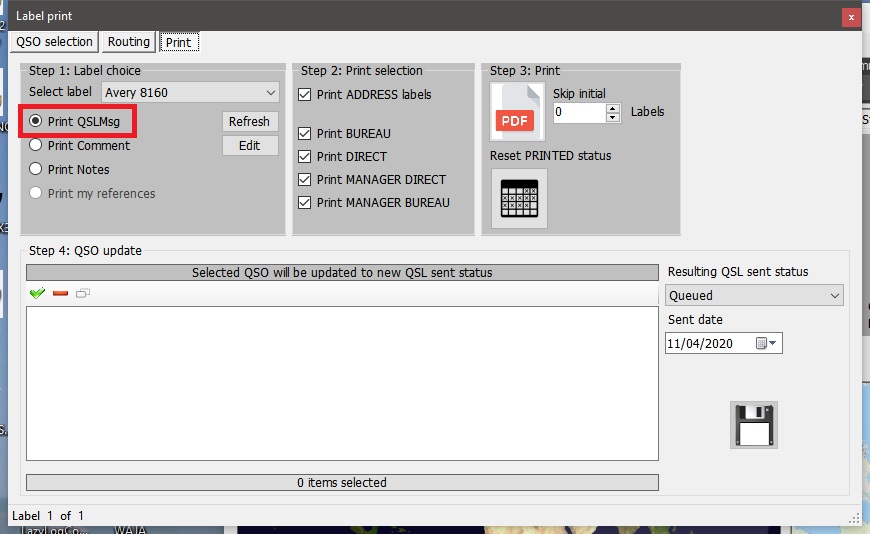

I would do it this way
and then

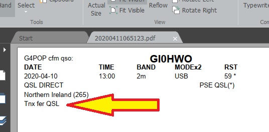

which results in this
