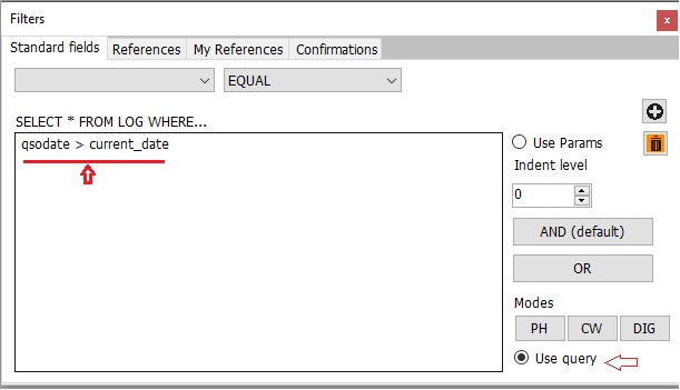

CT1BXX
Posts: 483
Joined: 21 Jan 2013, 15:27
Re: Filters with Query
Post by CT1BXX »
I would like to share with you, the query I was looking for. in case anyone needs, here is the PrintScreen.
I leave the question open, in case any colleague has a better opinion.
It would be extremely useful for the filters created, to be kept as they were in V1, to avoid typing.
I hope that Daniele considers this need. :)
73 Manuel Fernando CT1BXX
