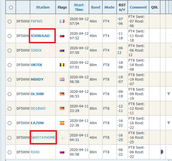

i am not a Member of qrz.com anymore so i can´t check. Simply try a new upload and after that check
the Log4OM Logfile. It will show you what V1 have send to qrz.com. See the Help Menu item to open
the Logfile.
But see my screenshot of the HRDlog.net site. Log4OM transmitting the full call to each external service.
the Logfile.
