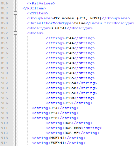

Re: JS8CALL and Log4om 2
Close Log4OM2, open rst.xml in the configuration folder. If done search for the block i made
a screenshot from. Insert <string>JS8</string> .... Save and close rst.xml, start Log4OM2 and
try again.

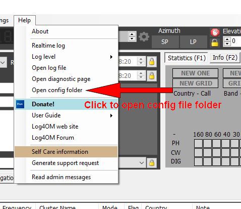

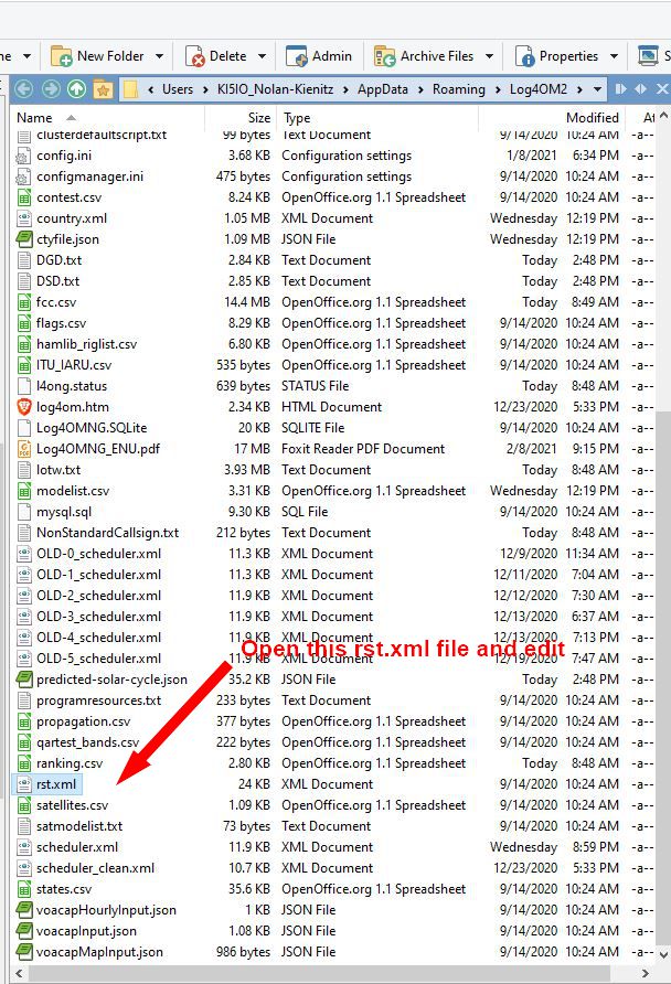

Roger,
With Log4OM V2 running go to: Help / Open Config Folder
Your file management APP will open the folder where all the configuration files are kept for Log4OM V2. You can then scroll through the folders/files and locate the file named: rst.xml
You can now open that file, but once you do shut down Log4OM V2.
Follow Juergen's directions to make the changes in the rst.xml file and save it. Close your APPs and then restart Log4OM V2 and your should find the changes noted.

DF5WW wrote: 07 Sep 2020, 03:56 Close Log4OM2, open rst.xml in the configuration folder. If done search for the block i made
try again.
