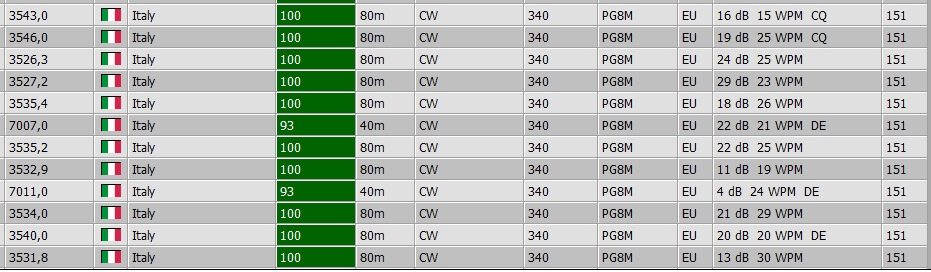

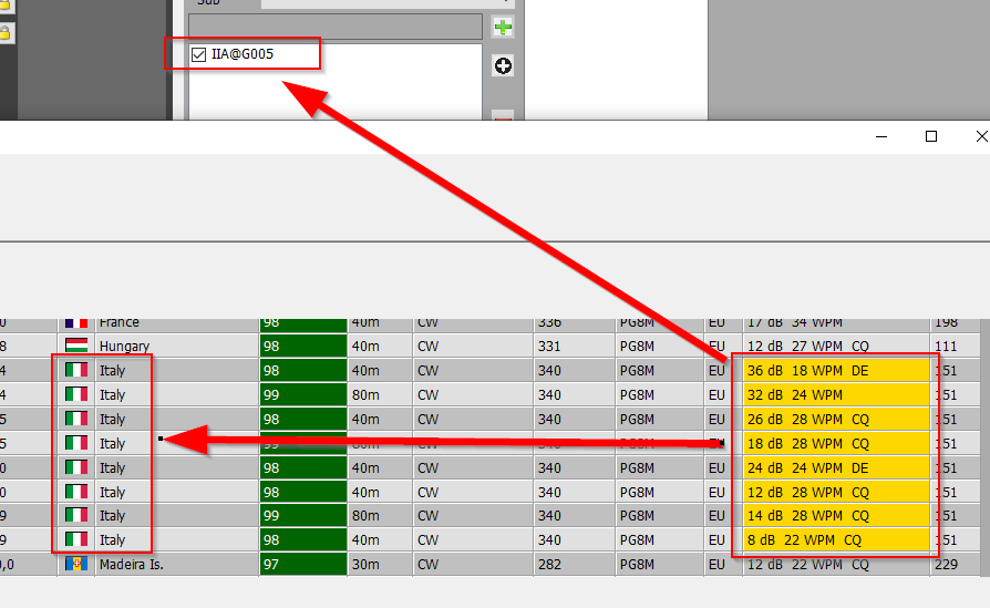

I get reference highlighting of dxcluster notes from CW skimmer spot in the cluster. it only happens for Italian stations and they all point to the same reference: IIA@G005

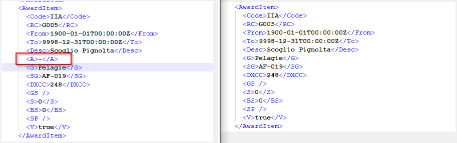

Looking in the Award XML i found that G005 in IIA is the only entry that has an "Alias" that consists of only a hyphen. <A>-</A>
Other entry's have a real alias or the alias field was not present.
I removed the alias field from the XML en reimported the award.
Problem solved
